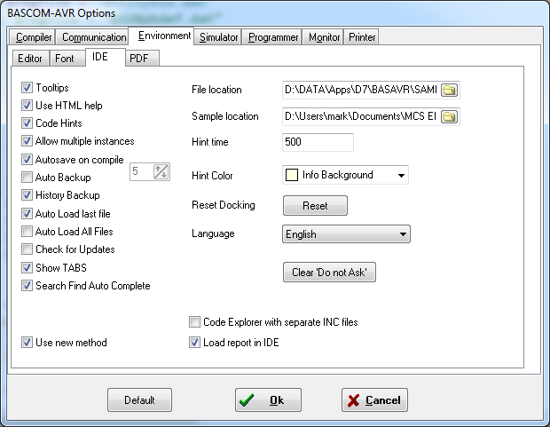

Options Environment IDE
| OPTION | DESCRIPTION |
| Tool tips | Show tool tips when hovering over form elements such as buttons. |
| File location | Click to select a directory where your program files are stored. By default Windows will use the My Documents path. |
| Sample Location | Click to select the folder where the SAMPLE files are located. They are either stored in a sub folder of the application, or in a folder under the Documents\MCS Electronics\BASCOM-AVR\samples folder |
| Use HTML Help | Chose between old help and CHM Help. CHM is the preferred help file. Since HLP is not supported under Vista, it is advised to switch to CHM/HTML Help. The HLP file is not distributed but using the UpdateWiz you can still download the HLP file. |
| Code hints | Select this option to enable code hints. You can get code hints after you have typed a statement that is recognized as a valid statement or function. |
| Hint Time | The delay time in mS before a code hint will be shown. |
| Hint Color | The background color of the hints. |
| Allow multiple Instances | Select this option when you want to run multiple instances of BASCOM. When not enabled, running a second copy will terminate the first instance. |
| Auto save on compile | The code is always saved when you compile. When you select this option, the code is saved under the same name. When this option is not selected, you will be prompted for a new filename. |
| Auto backup | Check this option to make periodic backups. When checked you can specify the backup time in minutes. The file will also be saved when you press the compiler button. |
| History Backup | This option creates a history backup of the source file each time you save it. When you Compile code, the active source will be saved too before compilation and hence it will create a history file as well. The history file is a version of the code saved in the HISTORY folder. This folder is located in the same folder as the main project. The file will be named <FILE>~yymmdd hhnnss.hst Where <FILE> is the original file name, and yymmdd is the date and hhNNss is the time. |
| Auto load last file | When enabled, this option will load the last file that was open into the editor, when you start BASCOM. |
| Auto load all files | When enabled, this option will load all files that were open when you closed BASCOM. |
| Check for updates | Select this option to check for updates when the IDE is started. |
| Show TABS | This option will enable/disable the TAB for multiple windows. While the TAB is convenient to switch between windows, it will also consume screen space. You can disable this option to get more screen space. |
| Reset docking | This will reset the dockable windows to the default position. |
| Search Find Auto Complete | This option can enable/disable the auto completion in the Find dialog. When it is active and you type some text, based on historical input, the text will be completed. This is not always desired and can be disabled. |
| Language | This will set the language in the main menu to the selected language. Not all listed languages are supported/translated yet. |
| Clear Do not Ask | Some messages have a 'do not ask again' option. To reset this and thus show the messages, you can click this button. |
| Use New Parser | When compiling a project, the main file is searched for some settings like $regfile, $hwstack, $swstack and $framesize. This information is passed to the compiler DLL. This search is fast but simple : it will not work correct when using directives such as : #IF someConditon $regfile = "m88def.dat" #ELSE $regfile = "m2650def.dat" #ENDIF The parser used for the code explorer is capable to get the information but requires more time because it will parse the entire project. So you have the option to choose the old method or the new method. In version 2087 the new parser is made default. It is good practice to start your project with the required info : $regfile = "yourmicro.dat" $hwstack=32 ' values shown as sample $swstack=32 $framesize=32
 We recommend that you always use 'New Parser' since the old method will be disregarded in a future update. This does mean that your main project code always need to contain the most important settings : $REGFILE, $HWSTACK, $SWSTACK and $FRAMESIZE. These settings override the optional project configuration settings. A future version will not use the configuration file settings since it is best that these settings are stored in the code.
 This setting is also required for the $PROGRAMMER directive. |
| Code Explorer with separate INC files | The Code explorer will put all elements in one tree without file names. Setting this option however will create a tree of elements with all file names under a branch named 'Inc Files'.
 Code explorer with separate inc files Code explorer without separate inc files

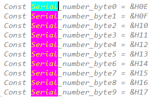

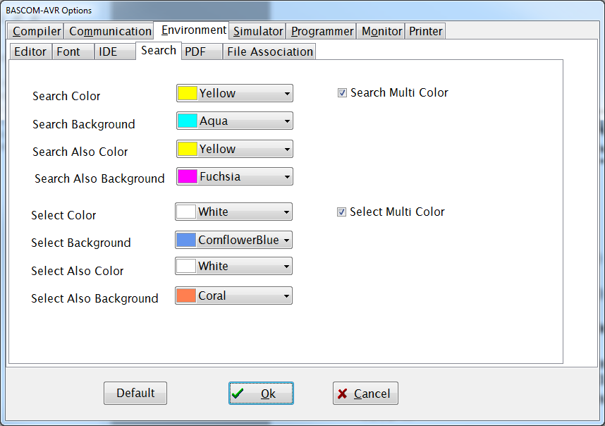

Options Search
Using the Search and select options you can customize the search and select colors.
You can also enable the option : Search Multi Color and Select Multi Color.
When search multi color is enabled all other matches will be highlighted too.
This sample shows what happens when you search for 'serial'. Note that that text is gray because of the 'Dead Code' option.
When you enable Select Multi Color, all text you select using the keyboard, mouse, or double click, will be highlighted the usual way. All other occurrences will be highlighted too.
This can be confusing.
The multi select coloring will do only what the name suggests : it will color the selecting text and all other occurrences. But when you perform an operation like replace, it will only be performed on the active selected text.

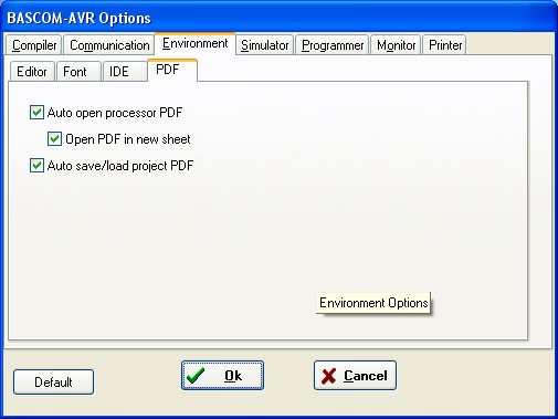

Options Environment PDF
| Auto open processor PDF | This option will automatic load the PDF of the selected micro processor in the PDF viewer. The $REGFILE value determines which data sheet is loaded. The PDF must exist otherwise it can not be loaded. |
| Open PDF in new sheet | Every time you change the value of the $REGFILE the processor PDF can be shown in the same sheet, or a new sheet can be shown with the PDF. A good option in case your project uses multiple processors. |
| Auto save/load project PDF | Load all PDF's when the project is opened that were loaded when the project was closed. |
