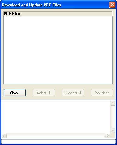

The following window will be shown :
There is only one option available : Check. When you click the Check-button, the MCS server will be checked for newer versions of the PDF documents.

During the check the window will look like this :
All PDF's that are newer will have a check mark. These need an update.
You can manual unselect or select the PDF's.
In the log window at the bottom of the window you can view which files will be downloaded.
When you want to download the selected files, press the Download-button.
