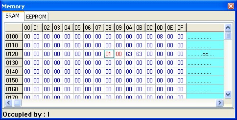

 Pressing this button shows the Memory window.
The values can be changed the same way as in the Register window.
When you move from cell to cell you can view in the status bar which variable is stored at that address.
The SRAM TAB will show internal memory and XRAM memory.
The EEPROM TAB will show the memory content of the EEPROM.
The colors work exactly the same as for the register and IO windows. Since internal ram is cleared by the compiler at startup, you will see all values will be colored blue. You can clear the colors by right clicking the mouse and choosing 'Clear Colors'.

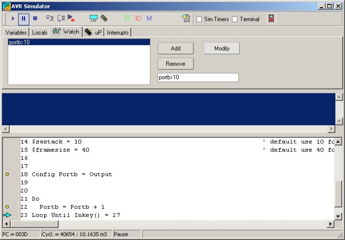

The Watch-TAB can be used to enter an expression that will be evaluated during simulation. When the expression is true the simulation is paused.
To enter a new expression, type the expression in the text-field below the Remove button, and press the Add-button.
When you press the Modify-button, the current selected expression from the list will be replaced with the current typed value in the text field.
To delete an expression, select the desired expression from the list, and press the Remove-button.
During simulation when an expression becomes true, the expression that matches will be selected and the Watch-TAB will be shown.

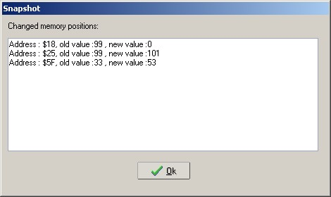

Pressing the snapshot-button will save a snapshot of the current register values and create a copy of the memory.
You will notice that the Snapshot-button will change to ‘Stop’
Now execute some code by pressing F8 and press the Snapshot-button again.
A window will pop up that will show all modified address locations.
This can help to determine which registers or memory a statement uses.
When you write an ISR (Interrupt Service Routine) with the NOSAVE option, you can use this to determine which registers are used and then save only the modified registers.

 The refresh variables button will refresh all variables during a run(F5). When you use the hardware simulator, the LEDS will only update their state when you have enabled this option. Note that using this option will slow down the simulation.

Start Simulation
To start a simulation the program need to be compiled. So typically you press F7 to compile your code. Make sure that the BIN, DBG and OBJ files are created (Options, Compiler, Output).
When the code is compiled without errors, you can simulate your project. To do so press F2.
By default the simulator is in STOP mode. The status bar will show PC = 0 (program counter) and Cycles = 0. Some instructions use more cycles than other. A NOP for example takes 1 cycle. When the processor has an oscillator running on 8 MHz, and the 8 DIV fuse is set, it means the processor will have a clock of 1 MHz. Meaning that each second, 1 million cycles can be executed. So you could execute a million NOP instructions in 1 second.
The simulator however is not able to do so. The simulator reads the object data, and decodes the data and simulates the instructions and the hardware. Also, the software need to give time to windows otherwise the code will stall windows and your other programs.
When the AVR is initialized, the RAM is cleared. This will takes time. So when you press F8 the first time, you will notice that the blue arrow will be visible on the first line of the main project. It depends on the used processor how long it will take till the initialization is done. When done, the simulator will go into PAUSE mode.
Press F8 again to step through the code. You will notice that the blue arrow will jump only to code with a yellow dot which indicates that the line contains executable code.
DIM statements for example are important for the compiler but do not create code. So these statements will be skipped.
Using the BREAK instruction you can pause the simulator. This is a good way when instead of F8, you use F5 to RUN the code. You can also set a break point using F9. This will be visible with a red dot.
When your code uses INC modules, the simulator will show the name of the current module.
