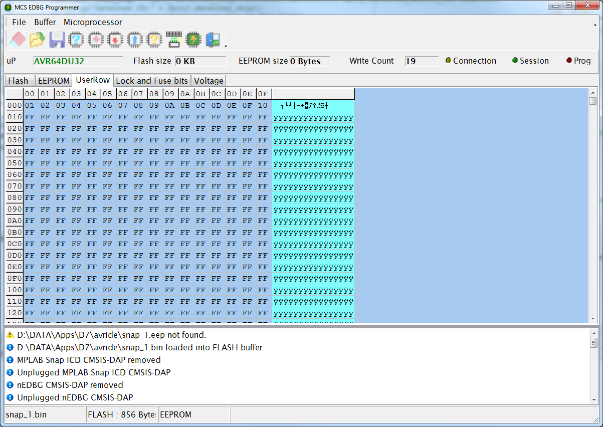

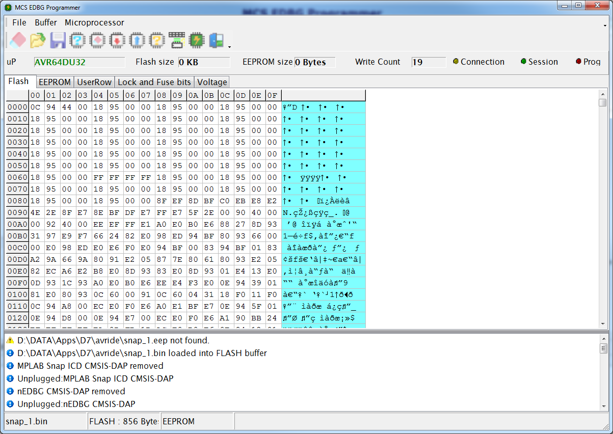

The programmer interface looks familiar:
The FLASH TAB will show the content of the FLASH buffer. The content is loaded automatically when a BIN file exists of your project.
The EEPROM TAB will show the content of the EEPROM buffer. This is loaded automatically when an EEP file exists of your project.
The USERROW TAB will show the content of the USERROW buffer. This is loaded automatically when a USR file exists of your project.

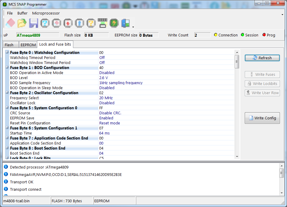

The LOCK and FUSE Bits TAB is intended to program the various fuses.

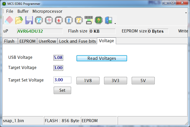

The VOLTAGE TAB can be used to change the target voltage. But only when your programmer supports this.
The INFO window on the bottom will show if a programmer is found. In this case it is the SNAP ICD.
The yellow led will lit when there is a connection with a programmer.
The Session led will lt when there is a session active.
The Prog led wil lit when programming is active.
When using automatic programming the session is created and ended automatically.
When using manual programming you have the option (in Options, Programmer) to keep the session active. This to improve speed. On the other hand the programmer uses USB and the speed is great.
Each time you program the flash memory the write count is increased. The serial number is used and stored in the file named updiserials.prg. The MCS UPDI programmer uses the same file to keep track of writing.

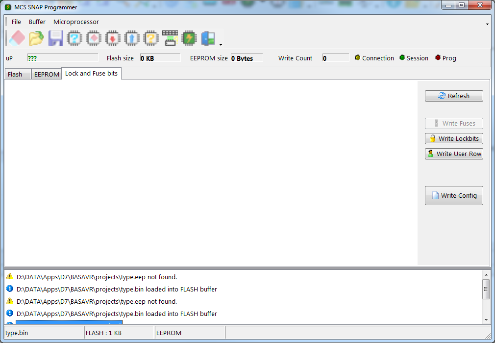

The Lock and Fuse bits TAB
By default the lock and fuse bytes are not loaded. You need to click the REFRESH button to load the values.
When you alter the value of a fuse, depending on the kind of fuse you alter, the WRITE FUSES button, WRITE LOCK BITS or WRITE USER ROW button becomes enabled.
Clicking the button will update the fuse value(s). And the Lock and Fuse bits are read again. Reading all values can take some time.
The WRITE CONFIG button will write the current Lock and Fuse bit value to the editor. That is : the value as read from the processor. This is NOT the value as you alter it.
The idea is that you first test the settings. When all works, you use the WRITE CONFIG button which will write a line like this to the current editor position :
Config Fuses=Off,Lock=OFF,Fuse0=&H00,Fuse1=&H40,Fuse2=&H02,Fuse4=&H00,Fuse6=&H07,Fuse7=&H00,Fuse8=&H04,UROW0=&H00,UROW1=&H00,UROW2=&H00,UROW3=&H00,UROW4=&H00,UROW5=&H00,UROW6=&H00,UROW7=&H00,UROW8=&H00,UROW9=&H00,UROW10=&H00,UROW11=&H00,UROW12=&H00,UROW13=&H44,UROW14=&H00,UROW15=&H00,UROW16=&H00,UROW17=&H00,UROW18=&H00,UROW19=&H00,UROW20=&H00,UROW21=&H00,UROW22=&H00,UROW23=&H00,UROW24=&H00,UROW25=&H00,UROW26=&H00,UROW27=&H00,UROW28=&H00,UROW29=&H00,UROW30=&H00,UROW31=&H00,UROW32=&H00,UROW33=&H00,UROW34=&H00,UROW35=&H00,UROW36=&H00,UROW37=&H00,UROW38=&H00,UROW39=&H00,UROW40=&H00,UROW41=&H00,UROW42=&H00,UROW43=&H00,UROW44=&H00,UROW45=&H00,UROW46=&H00,UROW47=&H00,UROW48=&H00,UROW49=&H00,UROW50=&H00,UROW51=&H00,UROW52=&H00,UROW53=&H00,UROW54=&H00,UROW55=&H00,UROW56=&H00,UROW57=&H00,UROW58=&H00,UROW59=&H00,UROW60=&H00,UROW61=&H00,UROW62=&H00,UROW63=&H00
The CONFIG FUSES line only contains values that differ from &HFF meaning that one of the bits is set.
By default FUSES and LOCK are always set to OFF. This means that the programmer will not process the fuses and locks.
When your project is done and you want to program more processors you can change the FUSES=OFF into FUSES=ON. Then recompile so this info is written into the project PRG file. And now when you auto program the processor, the fuses are also programmed.
The same applies for the locks : when you want to lock the processor, you change LOCK=OFF into LOCK=ON, then recompile. When you program the processor, the lock byte(s) is also programmed.
When the lock byte is set, only an UNLOCK allows to reprogram the processor. UNLOCK will erase the processor. So all content (EEPROM too) will be erased.

Voltages
The voltages TAB can read the USB voltage and the target voltage. When the programmer supports it you can also set the target voltages.
Use the 1V8, 3V3 and 5V preset buttons to set the voltage. Click the SET button to actual set the voltage.

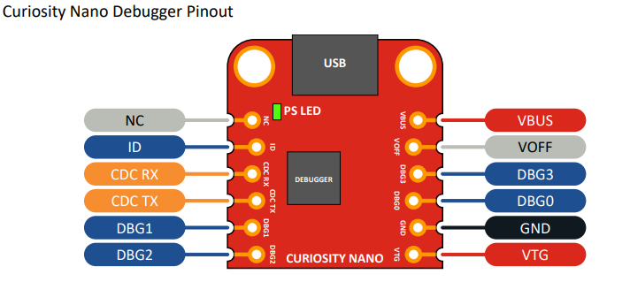

| PIN | DESCRIPTION |
| NC | Not connected |
| ID | ID line for extension |
| CDC RX | USB CDC RX line |
| CDC TX | USB CDC TX line |
| DBG1 | Debug clock line |
| DBG2 | Debug GPIO0/SW0 |
| VBUS | VBUS voltage for external use |
| VOFF | Voltage Off input. Disables the target regulator and target voltage when pulled low. Make it low to activate. |
| DBG3 | Reset Line |
| DBG0 | Debug data line. Connect to UPDI of the target processor |
| GND | Common ground. |
| VTG | Target Voltage |
For programming you connect GND to GND of the target. Connect VTG to the target processor when your target circuit does not need much power. Do not connect when your target has it's own power.
And connect DBG0 to the UPDI pin of the target processor. Optional you can connect DBG3 to the reset pin of the processor. Most processors have a fuse that must be programmer first in order to select reset for the pin. Otherwise it is just a normal pin.
The image shown is the programmer part of the curiosity board. You need to separate the PCB before you can use it to program other processors. Instruction on how to cut tracks you can find in the documentation of the curiosity board. By default the programmer/debugger is connected to the on board target processor. When you cut tracks or board you need to make wired connections in order to program in again.

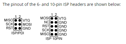

The ISP mode was tested with both Xplained boards : Xplained 168PB and Xplained 328PB.
The ISP mode has a fixed clock frequency for most boards we tried. In AS7 you will also not find a way to change the clock.

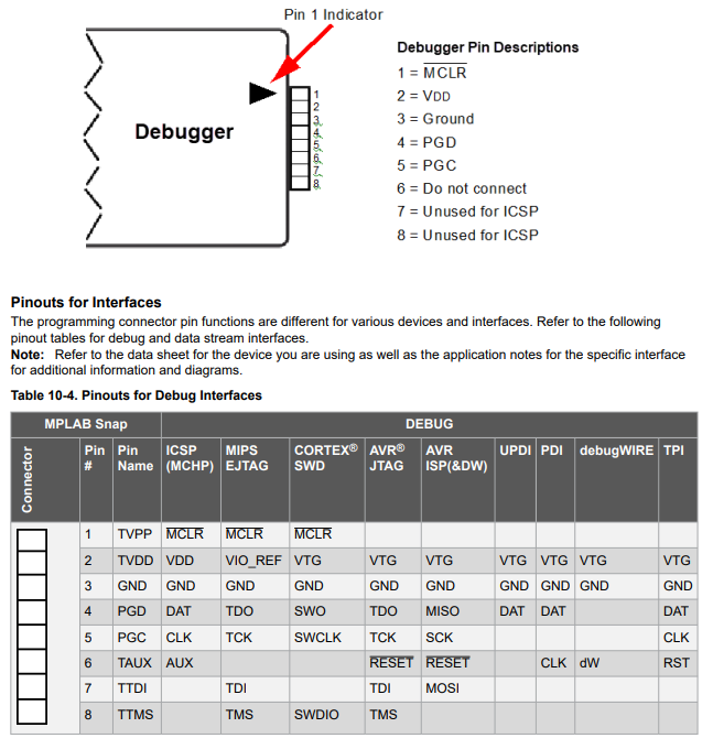

SNAP programmer info
For all supported mode you need to connect GND(ground) to pin 3 and VTG(vcc) to pin 2.
For UPDI you also need to connect the DAT to pin 4.
For ISP you need to connect MISO to pin 4, CLOCK to pin 5, reset to pin 6 and MOSI to pin 7.
For PDI you need to connect DAT to pin 4 and RESET to pin 6. While the table shows CLK for pin 6, it is actually connected to the RESET pin of the ISP connector.
 There is no option to select ISP, UPDI or ISP mode. The mode depends on the DAT file value from the $REGFILE directive in your code.
